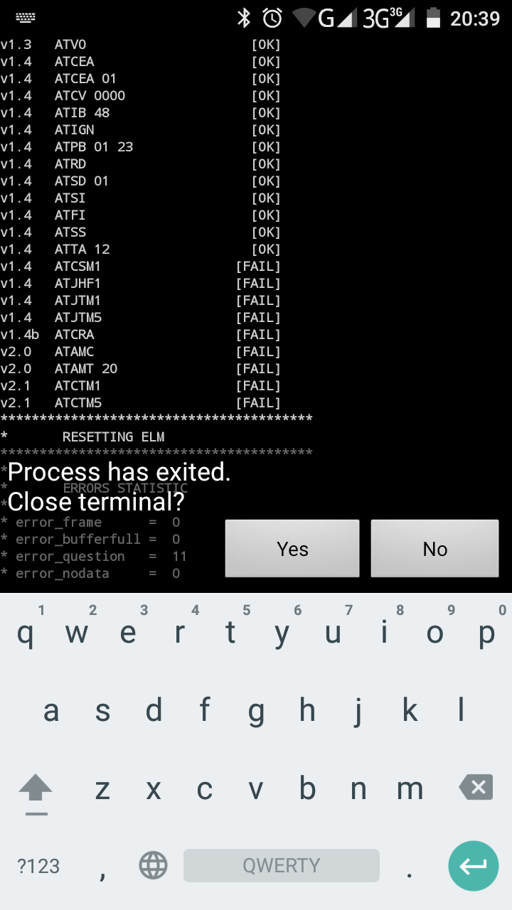

Проверил скриптом cmdr_chkelm один из своих плохих адаптеров
Spoiler
Opening ELM
v1.0   ATZ                      [OK]
v1.0   ATE1                     [OK]
v1.0   ATL0                     [OK]
v1.0   ATI                      [OK]
v1.0   AT@1                     [OK]
v1.0   ATAL                   [FAIL]
v1.0   ATBD                   [FAIL]
v1.0   ATBI                     [OK]
v1.0   ATCAF0                   [OK]
v1.0   ATCF 123               [FAIL]
v1.0   ATCF 12345678          [FAIL]
v1.0   ATCFC1                 [FAIL]
v1.0   ATCM 123               [FAIL]
v1.0   ATCM 12345678          [FAIL]
v1.0   ATCP 01                [FAIL]
v1.0   ATCS                   [FAIL]
v1.0   ATCV 1250              [FAIL]
v1.0   ATD                    [FAIL]
v1.0   ATDP                     [OK]
v1.0   ATDPN                    [OK]
v1.0   ATH0                     [OK]
v1.0   ATI                      [OK]
v1.0   ATIB 10                  [OK]
v1.0   ATIB 96                  [OK]
v1.0   ATL1                     [OK]
v1.0   ATM0                     [OK]
v1.0   ATNL                   [FAIL]
v1.0   ATPC                     [OK]
v1.0   ATR1                   [FAIL]
v1.0   ATRV                     [OK]
v1.0   ATSH 001122              [OK]
v1.0   ATSH 012                 [OK]
v1.0   ATSP A6                  [OK]
v1.0   ATSP 6                   [OK]
v1.0   ATST FF                  [OK]
v1.0   ATSW 96                [FAIL]
v1.0   ATSW 34                [FAIL]
v1.0   ATTP A6                  [OK]
v1.0   ATTP 6                   [OK]
v1.0   ATWM 817AF13E          [FAIL]
v1.0   ATWS                     [OK]
v1.1   ATFC SD 300000         [FAIL]
v1.1   ATFC SH 012            [FAIL]
v1.1   ATFC SH 00112233       [FAIL]
v1.1   ATFC SM 1              [FAIL]
v1.1   ATPP FF OFF            [FAIL]
v1.1   ATPP FF ON             [FAIL]
v1.1   ATPPS                  [FAIL]
v1.2   ATAR                   [FAIL]
v1.2   ATAT1                    [OK]
v1.2   ATIIA 01                 [OK]
v1.2   ATKW0                  [FAIL]
v1.2   ATSR 01                [FAIL]
v1.3   ATCRA 012              [FAIL]
v1.3   ATCRA 01234567         [FAIL]
v1.3   ATD0                   [FAIL]
v1.3   ATFE                   [FAIL]
v1.3   ATJE                   [FAIL]
v1.3   ATJS                   [FAIL]
v1.3   ATKW                   [FAIL]
v1.3   ATRA 01                [FAIL]
v1.3   ATS1                     [OK]
v1.3   ATSP 00                  [OK]
v1.3   ATV0                   [FAIL]
v1.4   ATCEA                  [FAIL]
v1.4   ATCEA 01               [FAIL]
v1.4   ATCV 0000              [FAIL]
v1.4   ATIB 48                  [OK]
v1.4   ATIGN                    [OK]
v1.4   ATPB 01 23             [FAIL]
v1.4   ATRD                   [FAIL]
v1.4   ATSD 01                [FAIL]
v1.4   ATSI                   [FAIL]
v1.4   ATFI                   [FAIL]
v1.4   ATSS                   [FAIL]
v1.4   ATTA 12                [FAIL]
v1.4   ATCSM1                 [FAIL]
v1.4   ATJHF1                 [FAIL]
v1.4   ATJTM1                 [FAIL]
v1.4   ATJTM5                 [FAIL]
v1.4b  ATCRA                  [FAIL]
v2.0   ATAMC                  [FAIL]
v2.0   ATAMT 20               [FAIL]
v2.1   ATCTM1                 [FAIL]
v2.1   ATCTM5                 [FAIL]
*       RESETTING ELM
*       ERRORS STATISTIC
* error_frame      =  0
* error_bufferfull =  0
* error_question   =  58
* error_nodata     =  0
* error_timeout    =  0
* error_rx         =  0
* error_can        =  0
*       RESPONSE TIME (Average)
* response_time    =  0.159005583993
    Uncompatible adapter on ARM core
      pyren would not work with it
          Result: 31 from 85
          Max version:v1.4
Только треть команд поддерживается ((((

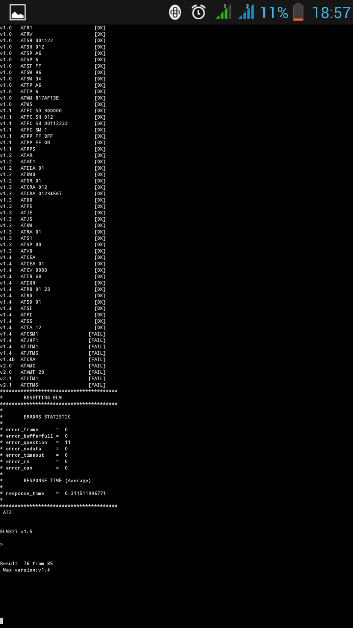

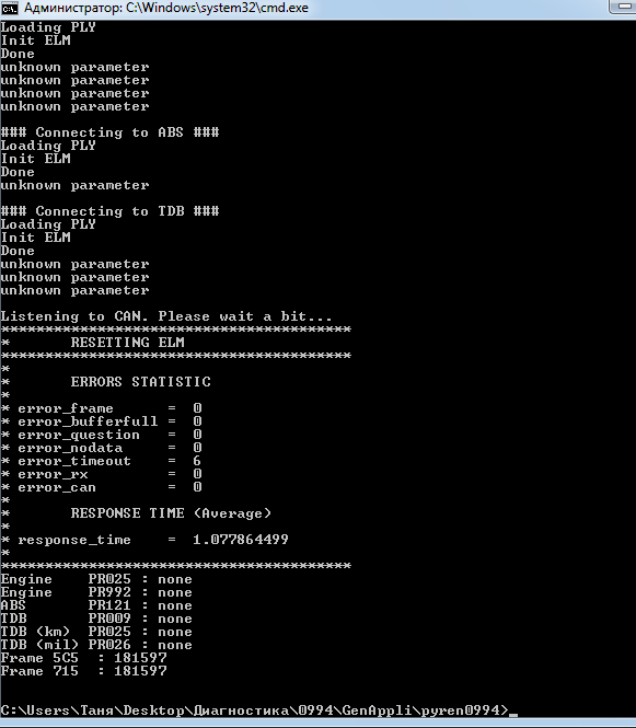

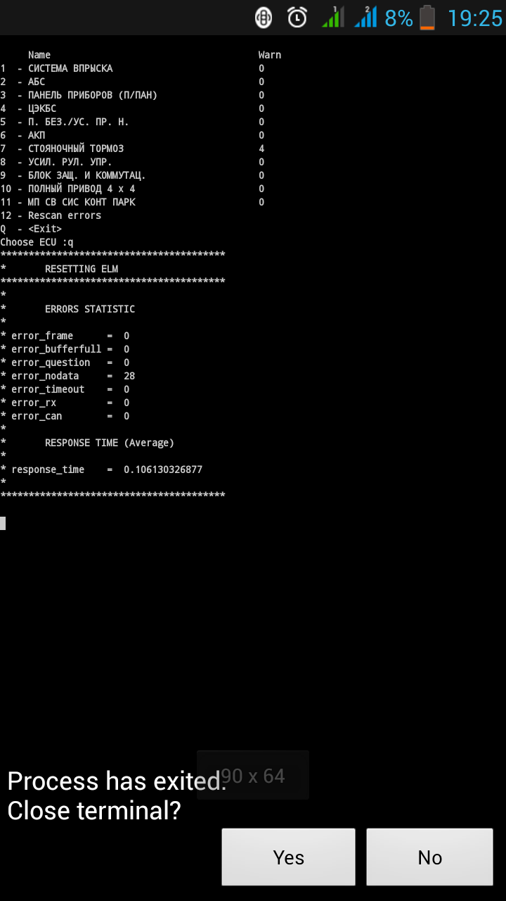

Сходил, протестировал.
Вот что показал скрипт проверки ELM. Жалоб на его работу нет, во всех прогах где требуют честный 1.5 работает. То что не ответили эти команды, критично?

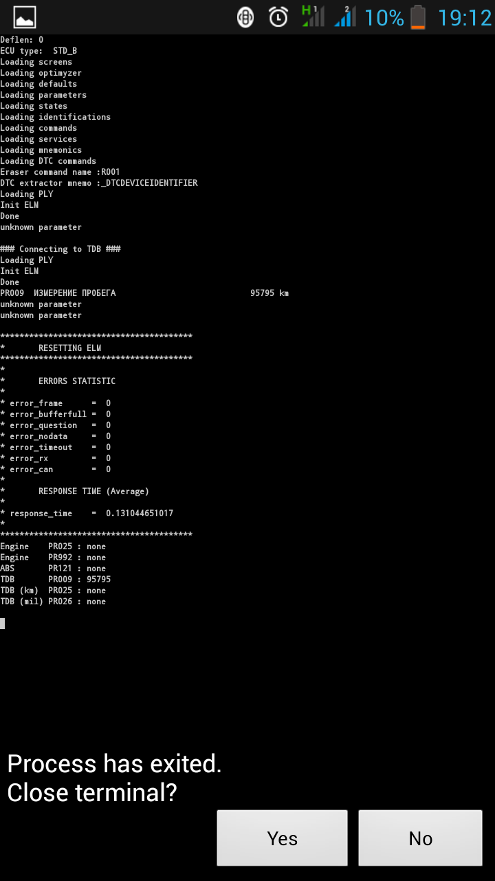

Вот что показал скрипт проверки пробега, с приборкой сошлось
Единственное, смутили ошибки "нодата" после тестирования машины. Думаю изза рассогласования в ошибках (в главном меню в ручнике показывает 4 ошибки, а при просмотре из блока 2)
Изменено пользователем DeviLav
Один в один и у меня такой показатель: 76 из 85! Пока что проблем с работой ELM327 что по Renault со скриптом, что с Mazda c FORScan, что Opel c ScanMyOpel и др.не заметил!
А как бы не сошлось, если пробег подцепился только из самой приборки? Смысл-то проверки, выудить больше информации о пробеге и из других блоков! Например, системы впрыска, ABS...
Все хорошо )) У вас самый что ни на есть обычный китайский v1.5
Дело в том, что канадская компания "ELM Electronics" https://www.elmelectronics.com/products/ics/obd/  никогда не делала чипов с прошивкой v1.5. После v1.4b  они сделали v2.0 и потом очень быстро v2.1
То что китайцы продают под маркой v1.5 это немного недоделанный аналог оригинального v1.4, этого достаточно чтобы с ним работали все программы. Команды на которых [FAIL] скриптом pyren не используются.
Если логи остались, давайте я посмотрю, откуда там nodata
нет - из-за этого вряд ли

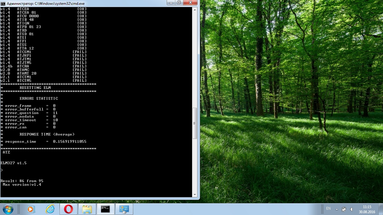

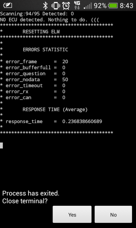

Проверил свои елмы.
Это на pic
А это на капле
На скринах все fail показаны

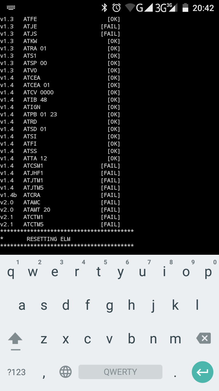

Подскажите. При запуске cmdr_chkelm тест отрабатывает и сам закрывается, не успеваю толком посмотреть, При запуске cmdr_odometr начинает слушать can шину и так же окно закрывается, диагностика работает, видит 7 блоков, стирает ошибки, версия 0994,запускаю с ярлыка на рабочем столе в свойствах Объект: C:\Users\Таня\Desktop\Диагностика\0994\GenAppli\pyren0994\cmdr_odometr.py -p com2
13 минут назад, alex_kan сказал:
два варианта:
1. сначала открывать командную строку (пуск - выполнить - cmd, затем перейти по полному пути и запустить скрипт). После завершения работы окно не закроется.
2. создать нужный bat-файлик, примерно с таким содержимым:

спасибо через cmd получился тест эльма, по пробегу вечером попробую
Получилось, но результат не радует, в чем может быть причина?
У Меган2 пробег можно посмотреть только в системных фреймах. Какие блоки посылают эти фреймы я не знаю. Командами пробег ни из одного блока не читается.
значит у меня во всех блоках пробег 181597 :russian:
А на приборке какой пробег? Такой же?

Установил pyren-v0994-beta, пробовал 2 адаптера - проводной и wifi. Авто Лагуна 2 Фаза 2, бензин S3000.
Проводной у меня вроде бы правильный, на pic.
Но, результат проверки плохой, как я понимаю, проверка выдает, что адаптер на ARM, хотя это не так (в параметрах com-порта пришлось выставить 38400 руками, по-умолчанию было 9600, но это не повлияло на результат):
python cmdr_chkelm.py -p com3 --log chkelm2.txt

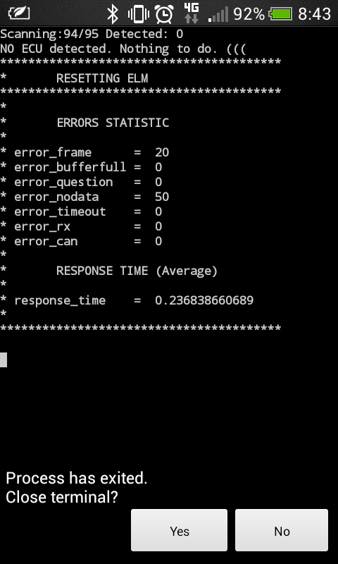

При попытке подключиться через putty и выполнить последовательность atz, ate1, atl1, atsh7e0, atcra7e8 - все норм. Но далее, при установке протокола atsp8 выдает "err94". Хотя сейчас посмотрел на результат chkelm - при atdp устанавливает SAE J1939 (CAN 29/250) - может, в этом причина и нужно ставить режим atsp9?
Тем не менее, при попытке запустить скрипт, тоже все плохо, не находит ни одного блока:
python pyren.py -p com3 --log log.txt --scan
#load: X74 LAGUNAII ph2 ../Vehicles\TCOM_121.Xml
#[08/31/16 10:51:15.101] Init CAN

Собственно, в логах ничего интересного. Адаптер просто не отвечает скрипту.
НО! при этом, при подключении через telnet кое-что получается:
 attzz
>aattee11.5
>aattll11
OK
>aattsshh77ee00
OK
>aattccrraa77ee88
OK
>aattsspp88

Почему-то ввод дублируется (не помню, как отключить это в телнете, не заморачивался, но в общем, и так понятно). Первые команды - atz, ate1, atl1. до ввода последней перевод строки не делается, поэтому не видно результат, но везде Ок.
Это пока что единственный адаптер, который ответил правильно на 10c0 после установки базовых параметров. Но ответы на другие команды 0100, 0105, 010с - какая-то лажа. Перед подачей этих команд подавал 10c0 для возобновления сессии.
Может я что-то упустил при "ручной" работе с адаптерами? Неправильно параметры задаю?
Подскажите, пожалуйста, куда копать...
Адаптер вроде действительно хороший но вот большое количество ERR94 меня смущает - я с такими никогда не сталкивался. Вот что про них сказано в DataSheet
Spoiler
One error that is not necessarily a result of an internal problem is ERR94. This code represents a ‘fatal CAN error’, and may be seen if there are CAN network issues (some non-CAN vehicles may use pins 6 and 14 of the connector for other functions, and this may cause problems). If you see an ERR94, it means that the CAN module was not able to reset itself, and needed a complete IC reset to do so. You will need to restore any settings that you had previously made, as they will have been returned to their default values.
Beginning with v1.3a of this IC, an ERR94 will also block further automatic searches through the CAN protocols, if bit 5 of PP 2A is a ‘1’ (it is by default). This is done because most ERR94s will be as a result of serious CAN wiring problems. Blocking of the CAN protocols remains in effect until the next power off and on, or until an AT FE is sent.
Возможно поэтому скрип определил адаптер как ARM
Скорее всего включен ATE1  и локальное echo в терминале. Можно сделать ATE0 если не известно как отключить локальное echo
