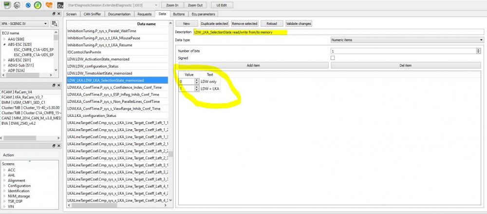

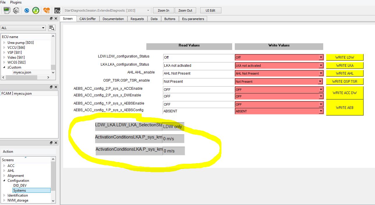

Hi friends,
I noticed that there are many commands in .xml files  of DDT4ALL . Unfortunately, they are not visible on the Screen bookmark. Only in Data. I just managed to add a line to the Screen.
For example this one:write.thumb.jpg.4cf4627dd6d6282a81bd6421461012b0.jpgmemorize.thumb.jpg.6d2b0c64e752f8fe43184325a84d0f34.jpg
Does anyone know how to write / read these parameters in ECU?
Is anyone able to modify .xml file to read and write these parameters?
LDW_LKA.LDW_LKA_SelectionState_memorized
ActivationConditionsLKA.P_sys_kmh_MinSpeedAct_LKA
ActivationConditionsLKA.P_sys_kmh_MinSpeedDeact_LKA
ActivationConditionsLKA.P_sys_kmh_MaxSpeedAct_LKA
ActivationConditionsLKA.P_sys_kmh_MaxSpeedDeact_LKA
THX

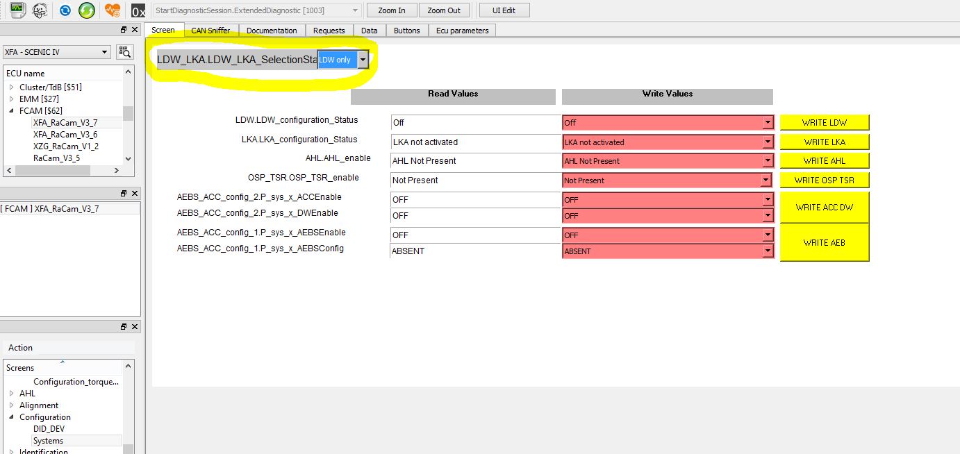

Which is your one? How did you decided it? First of all you have to scan your car and choose more appropriate xml. In case you make wrong choice you may damage your ecu
For my car, both are possible.  XFA_RaCam_V3_7 and RaCam_V4  Last time I use XFA_RaCam_V3_7 will be better.
But installed only one. Try to find in a log file responses on command 2180 or 22F1A0, 22F18A, 22F194, 22F195. It would help to decide more precisely which ECU installed in your car.
Also try to use pyren.py/mod_ddt.py. Which xml would be chosen by this software?

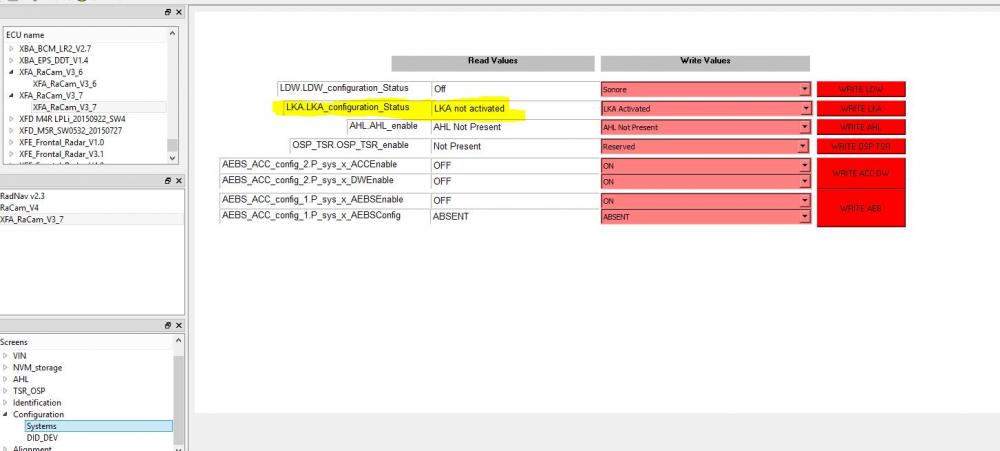

I used XFA_RaCam_V3_7 I activated LKA but I needed additional rows for other settings like this Screen. First read and then write :-)
I read you carefully ) but it is looks like you do not understand me. I want to say that it is very important to know exactly which xml to use on your RaCam.
If one command applied well to your ecu then it does not sure that all other commands would applied well too and not harm your ecu.  I just warn you and suggest to check all aspects twice before change something
15 минут назад, Shr-lnm сказал:
 I want to say that it is very important to now exactly which xml to use on your RaCam.
I understand, it's very dangerous. I assumed that if I select my car in ddt4all menu, are there only .xml files suitable for my ECU? And then if I can read this parameter (for example LDW_LKA.LDW_LKA_SelectionState_memorized ), it's safe.
I'll send a log.

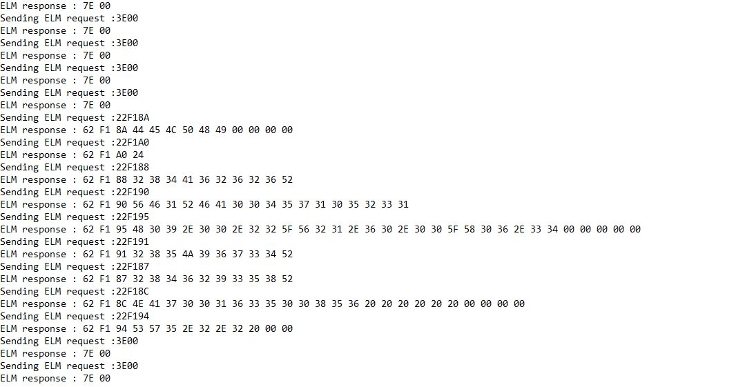

8 часов назад, Shr-lnm сказал:
I Try it, XFA_RaCam_V3_7  communicates without any problem. See log file.
Нужна помощь! Владею Scenic 2 всего пару месяцев. Срочно нужно включить принудительную регенерацию сажевого фильтра. Установил на ноут PyRen 174, купил elm 327 1,5v. Какой скрипт необходимо указать? Голова кипит...
Ok. Thank you for log in image format )))

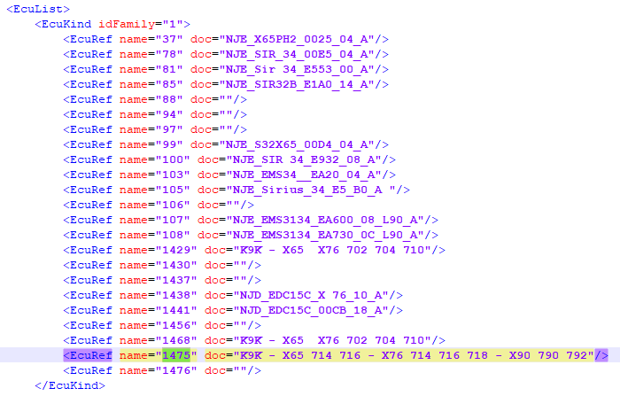

Any way. According to it you have RaCam with the next identity
<AutoIdent DiagVersion="36" Supplier="DELPHI" Soft="SW5.2.2" Version=""/>
I have no latest version of db right now, so try to find above string in yours eculist.xml
If you do not find exact such string then find closest. I've found the next one
<AutoIdent DiagVersion="36" Supplier="DELPHI" Soft="SW4.1" Version=""/>
in my db. It related to "XFA_RaCam_V3_3_4_20150814T134359.xml"
I've found the new db and now I sure that you need to use exactly XFA_RaCam_V3_7 and not XFA_RaCam_V4

Для изменения этих параметров проще написать свой скрипт, который будет читать текущее значение
222089
менять нужные биты затем писать
2E2089XXXXXXXXXXXXXXXXXXXXXXXXXX

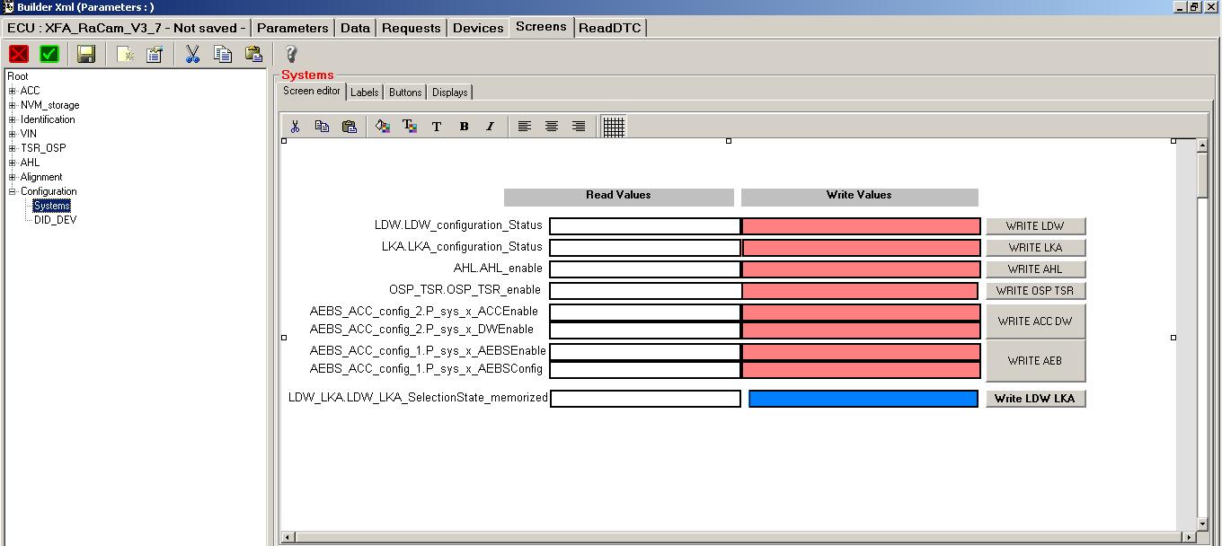

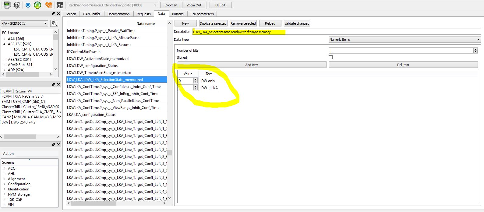

My idea was to add more read/write commands to the Screens and modify .xml. It looked like this:
Unfortunately, I can not add it. :-(
Первый параметр один управляется одной командой - с ним все достаточно просто.
Но вот остальные параметры
Управляются единой командой со множеством других параметров
<SentBytes>2E208900000000000000000000000000</SentBytes>
<DataItem Name="ActivationConditionsLKA.P_sys_kmh_MinSpeedDeact_LKA" FirstByte="4"/>
<DataItem Name="ActivationConditionsLKA.P_sys_kmh_MinSpeedAct_LKA" FirstByte="5"/>
<DataItem Name="ActivationConditionsLKA.P_sys_kmh_MaxSpeedAct_LKA" FirstByte="6"/>
<DataItem Name="ActivationConditionsLKA.P_sys_kmh_MaxSpeedDeact_LKA" FirstByte="7"/>
<DataItem Name="ActivationConditionsLKA.P_sys_mps_LatSpeedMax_LKA" FirstByte="8"/>
<DataItem Name="ActivationConditionsLKA.P_sys_m_MinLaneWidth_LKA" FirstByte="8" BitOffset="5"/>
<DataItem Name="ActivationConditionsLKA.P_sys_m_MaxLaneWidth_LKA" FirstByte="9" BitOffset="1"/>
<DataItem Name="ActivationConditionsLKA.P_sys_s_LKA_Max_Action" FirstByte="9" BitOffset="6"/>
<DataItem Name="ActivationConditionsLKA.P_sys_s_LKA_Min_Visibility_Time" FirstByte="10" BitOffset="4"/>
<DataItem Name="ActivationConditionsLKA.P_sys_x_LaneWidth_Derivative_Max_Thd" FirstByte="11"/>
<DataItem Name="ActivationConditionsLKA.P_sys_x_LaneWidth_Derivative_Min_Thd" FirstByte="11" BitOffset="7"/>
<DataItem Name="ActivationConditionsLKA.P_sys_s_HandsOffWheel_WarnTrsh" FirstByte="12" BitOffset="6"/>
<DataItem Name="ActivationConditionsLKA.P_sys_s_HandsOffWheel_StopTrsh" FirstByte="13" BitOffset="3"/>
<DataItem Name="ActivationConditionsLKA.P_sys_s_Drv_trq_Cut_Conf_time" FirstByte="14" BitOffset="1"/>
<DataItem Name="ActivationConditionsLKA.P_sys_s_LKA_Confidence_Index_Filter_Time" FirstByte="14" BitOffset="6"/>
<DataItem Name="ActivationConditionsLKA.P_sys_m_LKA_Min_Visibility_Distance" FirstByte="15" BitOffset="3"/>
<DataItem Name="ActivationConditionsLKA.P_sys_s_HandsOffWheel_StopTrsh_Inoperative" FirstByte="16" BitOffset="2"/>
Если делать экран, то его нужно делать сразу для всех этих параметров. Причем не факт, что это исчерпывающий список. Если команда описана не полностью, вы рискуете обнулить все недокументированные параметры, без возможности легко их восстановить.
Я рекомендую не делать экран, а написать скрипт по принципу:
-чтение текущего значения   222089
- изменение нужных бит
- запись измененных значений 2E2089xxxxxxxxxxxxxxxxxxxxxxxxxxxxxxxxx

I understand, can you change .xml at least the first parameter please (LDW_LKA.LDW_LKA_SelectionState_memorized)?
How to write a script according to the principle?

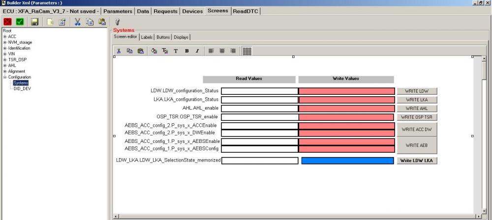

9 часов назад, Banana1 сказал:
ddt2000 BuilderX use
a practical example
https://expirebox.com/download/e4ce998bd120a748931855d97cc7b6dd.html
Изменено пользователем Dector
5 часов назад, Dector сказал:
  Показать
a practical example
Спасибо, ты лучший.
 BuilderX  is part of ddt2000? Does exist some freeware?
I have to try it :-)

Зачем например 37, 88 сценарии?

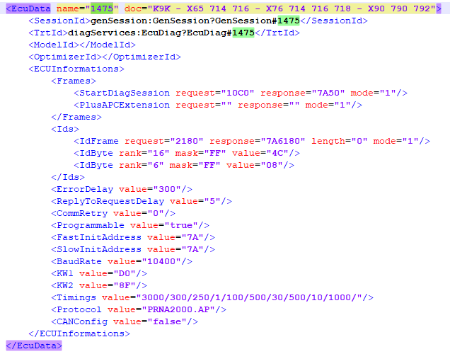

это не сценарии, это id блоков, которые на этот автомобиль ставятся.
On 16/03/2018 at 4:37 PM, igogo said:
Сам сценарий, как я понимаю, список параметров используя которые прибор может обратиться к устройству (двигателю например)?
В общем да, в FG/SG файлах содержится описание команд, параметров и ошибок конкретного блока. Сценариями в этой базе называются иные сущности.
В моем сценарии их нет. Почему?
Блоки с ID<10000 содержатся в старой базе и FG/SG файлов для них нет.

Пирен при подключении выдает ошибку   Bluetooth not ready for this connID.  Другие программы подключаются без проблем. Андроид 7.1.2 При подключении запрашивает доступ к блютуз, находит адаптер и дальше ошибки выдает. Думал может другие программы мешают — перегружал телефон и сразу пробовал подключаться. Выдает ту же ошибку. В логах одна повторяющаяся запись [09:29:24.498]<shifted> ATE1.
Что дальше делать ума не приложу. Демо режим работает без проблем.
Еще одно. Удалил адаптер, попробовал подключить через SL4A, адаптер видит а пароль не запрашивает
6 часов назад, PRIZRAK82 сказал:
Какой версии адаптер используете? Перед использованием протестировали на совместимость с версией, указанной производителем? Можно программой ELM Identifier. Она посылает те-же команды что и скрипт chkelm_4a_launcher.py. Для использования с PyRen-ом подходят не все китайские адаптеры elm327. Например адаптеры сделанные на "кляксе" могут работать с другими программами, а с ПиРен-ом не работать.
