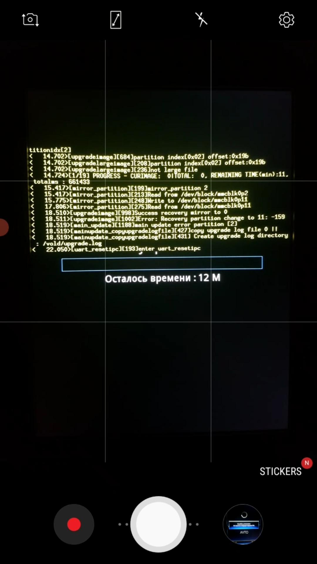

Не удалось обновиться. Доходит до этой строчки и все. Несколько раз перезагружается и пишет в конце
Ошибка установки. Оставлена текущая версия ПО
2036201744_Screenshot_20220218-193522_AZScreenRecorder.thumb.jpg.f0e5a6777ac0957f26e870601500640b.jpg
Логи установки
[mainupdate_rotation][848] ro.sf.hwrotation = 270
[uart_bootnotify][220]send IPC 1
[uart_bootnotify][223]send IPC 2
[uart_bootnotify][226]send CAN central display activation IPC
[miscpartition_setmode][285]theader.mode : [0]
[main_update][991]start main_update (Normal download)
[mainupdate_mountfatfs][492]blkpartnum[/dev/block/sdb1][1]
[miscpartition_getusbid][278]miscpartition_getusbid : 6a275b0a
[mainupdate_mountfatfs][503]usb id : [6a275b0a]
[mainupdate_getusbFatId][206]fat_type=185[mainupdate_getusbFatId][242]Unknown filesystem signature: , path=/dev/block/sdb
[mainupdate_getusbFatId][206]fat_type=0[mainupdate_getusbFatId][230]id=6a275b0a
[mainupdate_mountfatfs][523]origianl [/dev/block/sdb1] change usb block to [/dev/block/sdb1]
[mainupdate_mountfatfs][531]USB BLK NAME DETECTING
[mainupdate_mountfatfs][549]we can find USB(/dev/block/sdb1) util waitcount: 0
[mainupdate_mountfatfs][550]we will try mount USB(/dev/block/sdb1) /vold
[mainupdate_mountfatfs][576]we will try mount SDCARD(/dev/block/mmcblk0p4) /sdcard
[mainupdate_mountfatfs][593]we are done for mounting
[mainupdate_checkHAB][936] [ Secured H/W ]
[mainupdate_makefilepath][683]blkname (/dev/block/sdb1) pfilepath (/vold/R-LINK/mm2014_upgrade.lgu) filename (R-LINK/mm2014_upgrade.lgu)
[mainupdate_avoidchrckcrc][835]/vold/R-LINK/mm2014_upgrade.lgu will skip its CRC checking when it is opened
[parser_openupgradefile][846]len = 2, 11
[parser_openupgradefile][848]Finger print: updateall _gen34/mm2014_gen34:4.0.4/UNKNOWN/.20190523.132343:user/test-keys svn=persist.sys.aha.iap.production=true|9034610
[feature_getfingerprint][44]feature_getfingerprint (44)
[feature_getfingerprint][162]feature_getfingerprint (162): Start force update
[parser_matchfingerprint][284]Version info: devfingerprint [updateall]
[parser_matchfingerprint][285]Version info: headfingerprint [updateall]
[parser_matchfingerprint][295]Update all
[miscdualboot_initupgrade][132]MISC DUAL update index 0, usermode : 0
[miscpartition_setupgradestatus][202]result flashcopy
[mainupdate_calculatetotaltime][823]mainupdate_calculatetotaltime timesec : 661433
[miscpartition_setupgradestatus][202]result usbcopy
[miscpartition_incbootcount][298]theader.recoverybootcount : [6]
[main_update][1132]Recovery Boot Count : [6], haveimagetype=1, getimagetype=253
[main_update][1136]upgradeimgs : 19 curimg : 0
[mainupdate_upgradelogprepare][386] Upgrade log files index : 0
[main_update][1169]file_name[/vold/R-LINK/mm2014_upgrade.lgu] partitionidx[2]
[upgradeimage][684]partition index[0x02] offset:0x19b
[upgradelargeimage][208]partition index[0x02] offset:0x19b
[upgradelargeimage][236]not large file
[progress_log][44][1/19] PROGRESS - CURIMAGE:  0|TOTAL:  0, REMAINING TIME(min):11, totalms : 661433
[mirror_partition][199]mirror_partition 2
[mirror_partition][213]Read from /dev/block/mmcblk0p2
[mirror_partition][248]Write to /dev/block/mmcblk0p11
[mirror_partition][275]Read from /dev/block/mmcblk0p11
[upgradeimage][998]Success recovery mirror to 0
[upgradeimage][1002]Error: Recovery partition change to 11: -159
[main_update][1188]main update error partition [2]
[mainupdate_copyupgradelogfile][427]copy upgrade log file 0 !!
[mainupdate_copyupgradelogfile][431] Create upgrade log directory : /vold/upgrade.log
Кто-нибудь сталкивался?

17 часов назад, ganamn сказал:
а флешки под FAT32 кто с каким размером кластера форматирует?
ПРобовал 2 флешки и sd card, на 2 все идентично как я описал, а на 3 - вообще пишет не могу установить более старую версию
2 минуты назад, ganamn сказал:
Я размер кластера не трогаю, форматирую с дефолтным.
Флешки в машине читаются и установка с них идет.

1 hour ago, ganamn said:
Но у меня не получилось перейти с v7.
Здесь что то либо с флешкой, либо с сохранностью файла.
 Я брал обычный патч с gpspower.net, когда переходил с v7 на v8
Ошибка "оставлена предыдущая версия" выдаётся в случае, если какие-то из файлов не прошли проверку. Причины могут быть разные: с ошибкой скачалось, не правильно записалось, писали под Маком, глючная флэшка, плохой контакт в разъёме и т.д.
У меня у самого даже при установки с вполне рабочей флэшки иногда бывает такая ошибка. Во флэшке я уверен, поэтому просто запукаю ещё раз и в 99% случаев всё устанавливается.
Пробовать на 9 через 8 можно, но смысла никакого. Каждая версия переписывает всё.

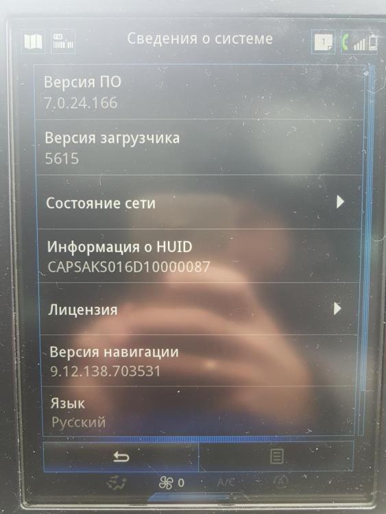

Здравствуйте почитал этот форум немного. Как я понял чтобы получить максимально информативные карты мне нужно установить скин патч 1.2, потом накатить карты here, и по желанию камеры контроля. Так ли это? Версия 7.0.24.121, нужно ли повышать до 8 или 9, или разницы особой не будет?
Разве что v7 можно повысить до .161
1 час назад, Simulacra сказал:
Уже сделал. Все оф. обновления через toolbox накатил
В начале форума есть инструкция. Я не следовал ею, поскольку не использую скин пачт и выложенные здесь карты. Для моей местности они не подходят.
Посмотрите, там должна быть вся необходимая информация. Просто ставите патч, который для вашей версии предназначен.
4 часа назад, kapysta сказал:
Можно поставить Скин-патч 1.3RC11: https://www.club-renault.ru/forum/topic/83495-neoficialnye-dorabotki-i-modifikacii-sistemy-r-link-2/?do=findComment&comment=2376736
На информативность карт это не повлияет, всё зависит от карт. Для Украины карты HERE имеют лучшую детализацию, чем TomTom.
