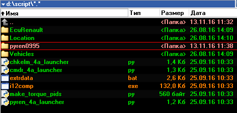

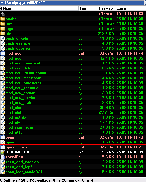

Установил:
1.python-2.7.12.msi + pyserial-2.7.win32_py3k.exe (для Win XP)  -c:\Python27
2.Clip_base_160.rar (EcuRenault,Location,Vehicles) -d:\script\
3.pyren-v0995-beta    -d:\script\pyren0995\
4.savedEcus.p - Для запуска демо-режима          -d:\script\pyren0995\savedEcus.p
5.pyren_demo.bat -запуск скрипта в демо-режиме   -d:\script\pyren0995\pyren_demo.bat
6.pyren.bat — запуск скрипта в обычном режиме    -d:\script\pyren0995\pyren.bat
7.mod_ecu.bat — создание PID для Torque          -d:\script\pyren0995\mod_ecu.bat
COM-порт автоматически не нашёл(script\pyren0995>pyren.py):
ColorConsole  [Version 2.4.4000 ]
Microsoft Windows XP [Версия 5.1.2600]
(С) Корпорация Майкрософт, 1985-2001.
d:\script\pyren0995>pyren.py
usage: pyren.py [-h] [-v] [-p PORT] [-s SPEED] [-r RATE] [-L LANG] [-m CAR]
                [-vv] [-e ECUID] [--si] [--cfc] [--n1c] [--csv] [--csv_only]
                [--csv_human] [--log LOGFILE] [--scan] [--demo]
pyRen - python program for diagnostic Renault cars
optional arguments:
  -h, --help      show this help message and exit
  -v, --version   show program's version number and exit
  -p PORT         ELM327 com port name
  -s SPEED        com port speed configured on ELM
                  {38400[default],57600,115200,230400,500000} DEPRECATED
  -r RATE         com port rate during diagnostic session
  -L LANG         language option {RU[default],GB,FR,IT,...}
  -m CAR          number of car model
  -vv, --verbose  show parameter explanations
  -e ECUID        index of ECU (like as 10016)
  --si            try SlowInit first
  --cfc           turn off automatic FC and do it by script
  --n1c           turn off L1 cache
  --csv           save data in csv format
  --csv_only      data doesnt show on screen for speed up
  --csv_human     data saves to csv in readable format
  --log LOGFILE   log file name
  --scan          scan ECUs even if savedEcus.p file exists
  --demo          for debuging purpose. Work without car and ELM
Available COM ports:
  File "d:\script\pyren0995\pyren.py", line 276, in <module>
    main()
  File "d:\script\pyren0995\pyren.py", line 208, in main
    optParser()
  File "d:\script\pyren0995\pyren.py", line 181, in optParser
    print "%-30s \n\tdesc: %s \n\thwid: %s" % (port,desc.decode("windows-1251"),hwid)
  File "C:\Python27\lib\site-packages\colorama\ansitowin32.py", line 40, in write
    self.__convertor.write(text)
  File "C:\Python27\lib\site-packages\colorama\ansitowin32.py", line 141, in write
    self.write_and_convert(text)
  File "C:\Python27\lib\site-packages\colorama\ansitowin32.py", line 169, in write_and_convert
    self.write_plain_text(text, cursor, len(text))
  File "C:\Python27\lib\site-packages\colorama\ansitowin32.py", line 174, in write_plain_text
    self.wrapped.write(text[start:end])
UnicodeEncodeError: 'ascii' codec can't encode characters in position 39-54: ordinal not in range(128)

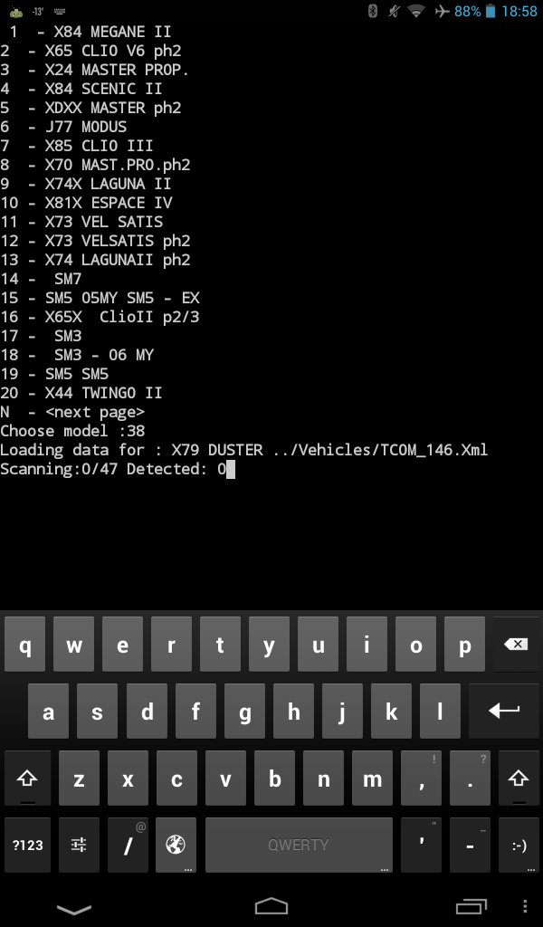

Ох, не хватает немного FAQ'а. Мои вопросы, наверное, стандартные, но что-то не могу найти ответа, хотя на 1й, вроде, где-то пробегал. Пользую под Win XP. Поставив Python 2.7 и задаунгрейдив его pyserial до 2.7 (делается, кстати, штатно командой pip install pyserial==2.7). Под андроидом у меня почему-то вообще питоновые скрипты не работают, даже родной hello_world.py - происходит тишина, потом сообщение что скрипт закончил свою работу. Итак, вопросы:
1. pyren0991 - видит два блока. А pyren0995 успешно всё сканирует, но не находит ни одного.
2. как можно победить кодировку русских букв? Оно у меня кракозябрами с вопросиками пишет. А включить английский не получается, потому что база CLIPа урезанная, только с русским. Что делать? Искать полноценную базу CLIPа с английским (французских я не понимаю)? Наверное, это лучше, качество перевода технической литературы на английский обычного в разы лучше, чем на русский. Или можно пока как-то где-то просто исправить кодировку pyren'я на 1251 или настройки винды, чтобы в консоли UTF-8 показывала?
Попробуйте 996. Там для duster есть изменение. Ну и логи пришлите посмотреть.

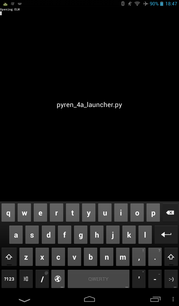

есть, но блин уже неделю не могу соединить скрипт с ELMкой из под Андроида - не связывается с адаптером почему-то. Адаптер правильный, на правильном чипе, все проверки проходит, в других программах (торк, хоб-драйв, OBDscope) работает без проблем. Не пойму куда копать. После запуска скрипта (разные версии пробовал) и выбора блютуз-устройства тишина...
Такая картинка на всех версиях до 995, на 991 выскакивает выбор автомобилей, но соединения с ЕЛМ тоже нет, потому что после не находит вообще никаких блоков.
Логирование включено, но логи нулевые почему-то.
На некоторых версиях андроида такая ерунда встречается. Закономерность пока не выявлена. Скорее всего android блокирует доступ из библитеки sl4a к стеку BT

3 часа назад, HID сказал:
Вот тут ничем не помогу, почему-то на моём Samsung Galaxy Tab 7.7 вообще питоновые скрипты не работают. SL4A и Python поставились без проблем, питон обновился. Но всё молча не работает.
3 часа назад, Shr-lnm сказал:
Андроид 4.2.2 планшет китайский CUBE U51GT-C4B. Т.е. решение только - сменить андроид-устройство, или можно еще что-то сделать?

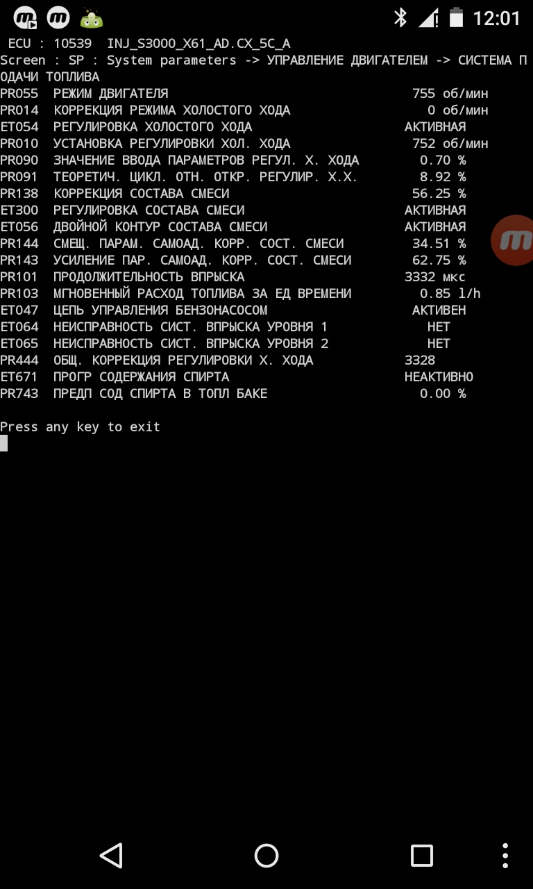

Добрый день! Спасибо за скрипт. Вещь очень полезная. Через андроид залез в ЦЭКБС по cmd расширенные функции. Пункт CF014  свет дневного движения. было без, выполнил команду, теперь постоянно "с". При заводке включается ближний и габариты, даже если выкл. Автосвет кнопка не реагирует. Скрипт выполняет только активацию функции. Помогите, пожалуйста, теперь отключить?)
Изменено пользователем Саныч35
Вы уже не первый, кто на эти грабли наступил ))))
https://cloud.mail.ru/public/7wLx/9Fg8L7VXm
попробуйте так
day_light_off.py -p COMx  --log=dlo.txt
1 час назад, Shr-lnm сказал:
попробуйте так
файлик закинул на планшет, с которого подключался. а строку где так прописать?
Если на планшете, то редактируйте cmdr_4a_launcher там в самом начале есть строчка типа
cmdr_file = "blabla"
Вместо blabla впишите название скрипта и запустите лаунчер
